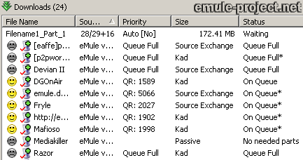

      eMule uses different means to find sources for downloads. Expanding
      a download by double clicking on it shows how the sources have been
      found in the Size column.

      Once another client is added as a source it gets queried for the
      current source status . Possible source status are:
      On Queue and QR: xx
      This is the Queue Rating. It denotes the waiting place in the queue
      of this client. When the beginning of the queue is reached, i.e.
      QR:1 this source will start uploading data.

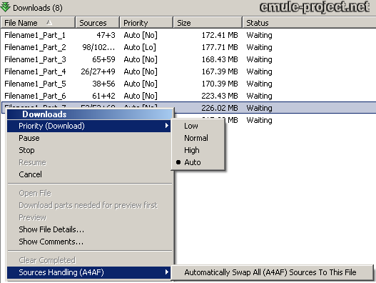

  This picture shows some downloads with their found sources (Advanced
  Controls turned on). The fourth file for example has 27 sources in
  total of which 26 are useful and 49 are A4AF.
  If downloads belong to a series of files or are split into multiple
  parts, eMule will show a source distribution alike the picture above
  for Filename1_Part_X. It is most likely that the sources found for one
  of the files could also provide parts of the other as they belong
  together. eMule occupies only one queue place on the sources hence the
  high count of A4AF for these files.
  There are two controls offered in this context menu to deal with these
  A4AF sources on a per file basis. The Priority and the
  Automatically Swap All Sources To This File control.
